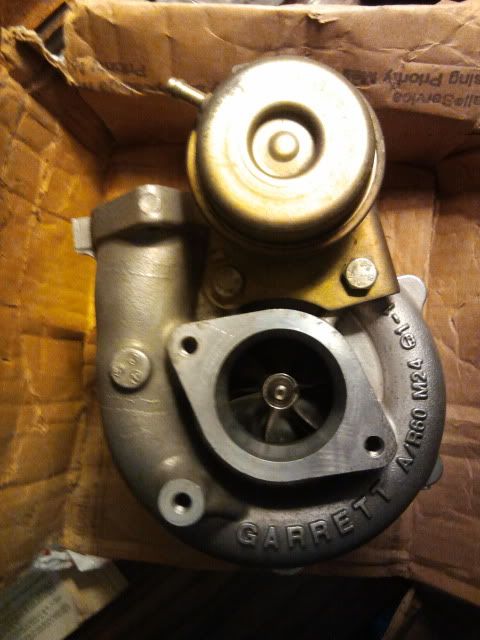

PostSubject: Re: Ooo Dang broke build   Ooo Dang broke build - Page 5 Icon_minitimeApril 7th 2011, 1:46 pm
Newer turbo

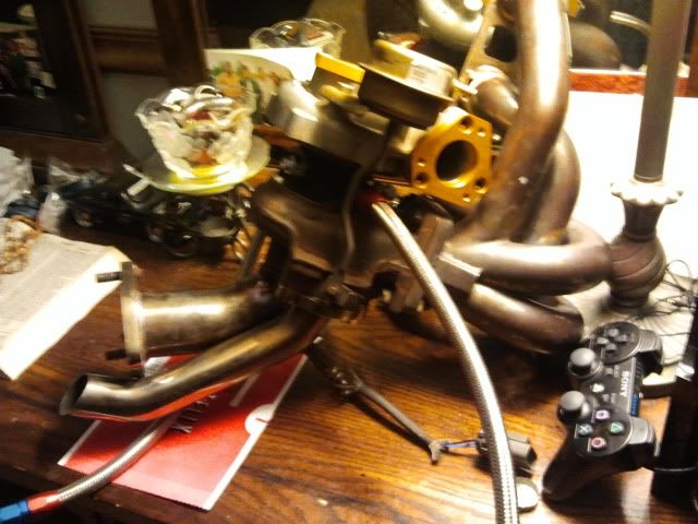

Ooo Dang broke build - Page 5 2011-04-15184240
Put everything back together. Stopped by tf picked up some stance clocking plates I guess I needed. Also gaskets for all that crap above.

PostSubject: Re: Ooo Dang broke build   Ooo Dang broke build - Page 5 Icon_minitimeApril 17th 2011, 9:54 am
why did you need those clocking plates? i thought it was for when you upgrade to like GT series turbos or something?
Number of posts : 1310
Ooo Dang broke build - Page 5 Empty
PostSubject: Re: Ooo Dang broke build   Ooo Dang broke build - Page 5 Icon_minitimeApril 17th 2011, 7:20 pm
T25 and t28 are different. They are suppose to clock the compressor inlet and outlet housings back to how they are on a t25
Ooo Dang broke build - Page 5 T25_vs__002

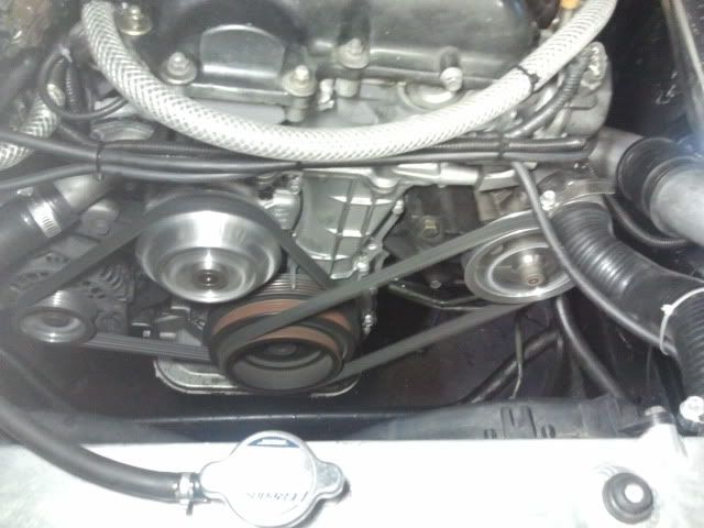

Now that the new turbo is in. Finally got around to doing my power steering.
Ooo Dang broke build - Page 5 2011-04-25183543
I guess my bov was broke or someshit, It made my car run like shit, would not release air so it would come out of the air filter. replaced that bitch and it sounds way better, cant really check if it runs better seeing that my car is sitting on jack stands. Im excited to see if this fixes my sputtering issue.
Ooo Dang broke build - Page 5 Th_video-2011-04-25-14-04-16
Oh and I ordered a slim hub the other day. I want a wood grain, I think Im going to run one of them wood grain wheels that are always on zilvia for now.

PostSubject: Re: Ooo Dang broke build   Ooo Dang broke build - Page 5 Icon_minitimeApril 26th 2011, 2:21 am
end of helicoiling that hole, or just saying fuck it for now?
PostSubject: Re: Ooo Dang broke build   Ooo Dang broke build - Page 5 Icon_minitimeApril 26th 2011, 3:19 am
Jebus just retapped it. worked like a charm.

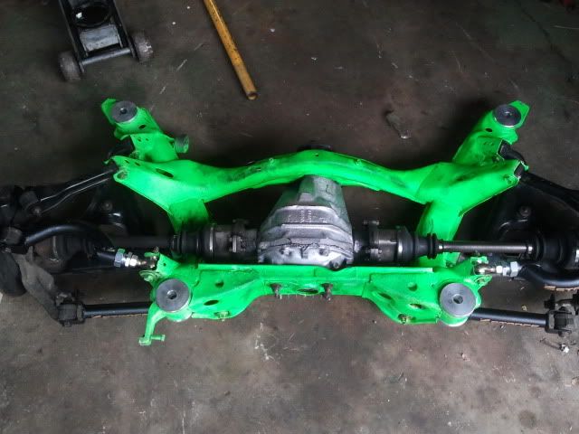

Front ss lines are done.
Ooo Dang broke build - Page 5 2011-05-04100806
Got the open welded by cm werks. Looks pretty good.
Ooo Dang broke build - Page 5 2011-05-04111137
Ooo Dang broke build - Page 5 2011-05-04104537

PostSubject: Re: Ooo Dang broke build   Ooo Dang broke build - Page 5 Icon_minitimeMay 4th 2011, 12:21 pm
Damn dude, shoulda gone to Vinny..
PostSubject: Re: Ooo Dang broke build   Ooo Dang broke build - Page 5 Icon_minitimeMay 4th 2011, 1:20 pm
^^^ that.
PostSubject: Re: Ooo Dang broke build   Ooo Dang broke build - Page 5 Icon_minitimeMay 4th 2011, 1:29 pm
Whats wrong with it?
PostSubject: Re: Ooo Dang broke build   Ooo Dang broke build - Page 5 Icon_minitimeMay 4th 2011, 1:45 pm
when you weld a diff you should always box them in.
like so
Ooo Dang broke build - Page 5 1199941026_2_FT911_sp1020610
PostSubject: Re: Ooo Dang broke build   Ooo Dang broke build - Page 5 Icon_minitimeMay 4th 2011, 1:53 pm
Doesn't really matter. Both are about the same price. Cm is closer and both guarantee their work.
