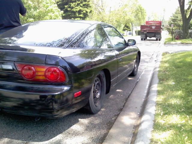

I bought my car in May of 08. 93 hatch, Came with kouki tails intake other then that twas pretty much stock. Only downfall was the high miles.(220k)ish. but still ran strong.

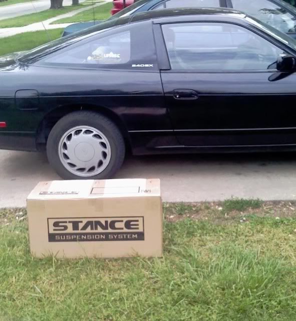

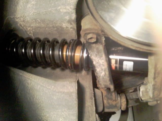

On the way home from buying it i made a quick pit stop at touge factory and got my Coils (stance al+ pro)
Ooo Dang broke build IMAGE_003
First thign before anything slammige.

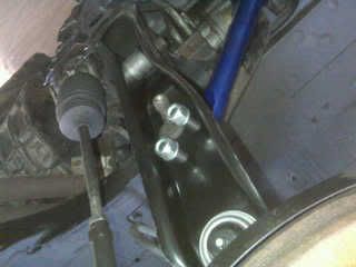

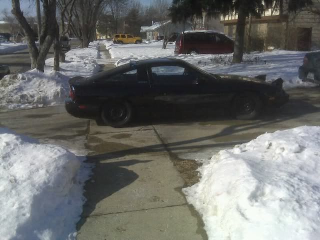

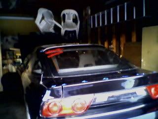

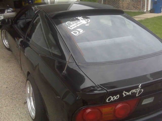

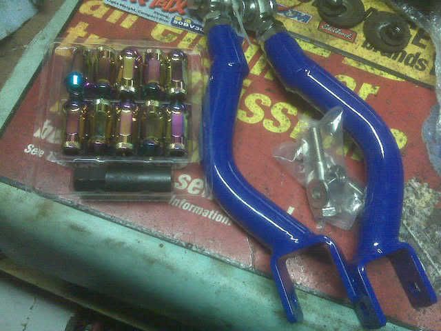

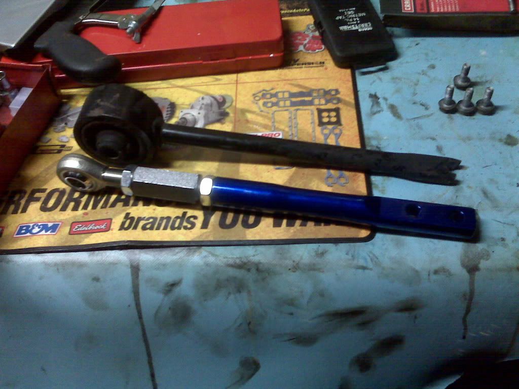

The rest of the summer was pretty much getting use to the car (breaking links welded diffs ect..) I sold the 002s and put it away for winter. That winter i bought some PDM racing oem control arms circut sport tension rods tien inner and outer rods s14 circut sport ruca's (word on the street was they would work on s13's but they dont) some fancy lug nuts and Origin roof spoiler and Origin 3 piece hatch spoiler and some window visors

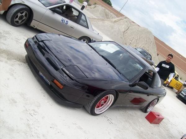

Tax return season hit and i needed wheels so i came across some work equip 03s on craigslist.
Front 15X8 +23
Rear 15X9 +23

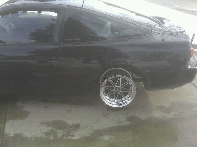

Front 15X8 -2
Rear 15X9 -15

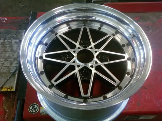

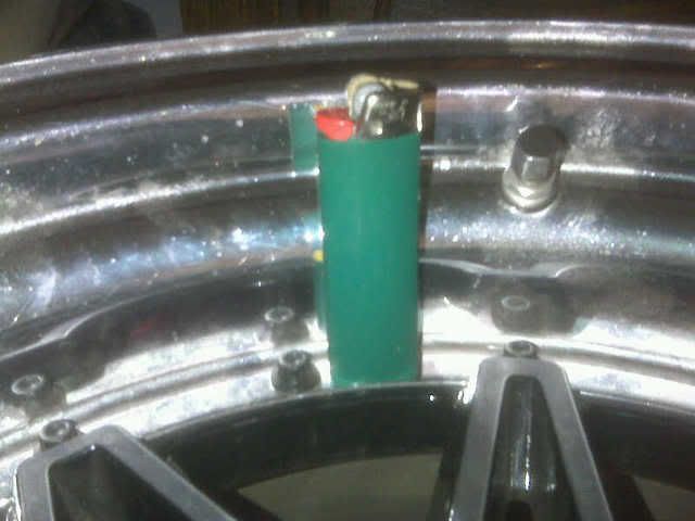

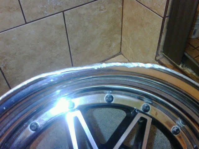

This last winter times were tough got laid off so i didnt do much to the car. srayed under coating in the hatch and sent a wheel i fucked up for fixing.
Ooo Dang broke build IMG00106
before
Ooo Dang broke build IMG00094
after

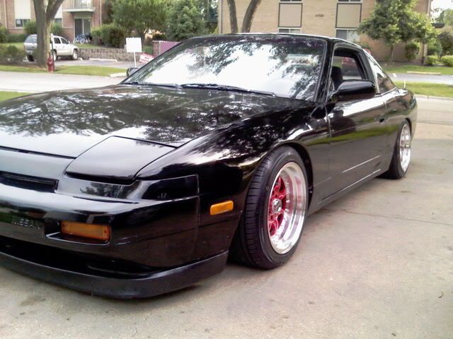

Fixed the body a bit got better fenders and hood, the old ones were cracked, dented the works. Thus is why im currently rocking a blue fender grey hood and a weird black fender. Also went lower all around

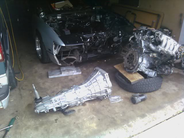

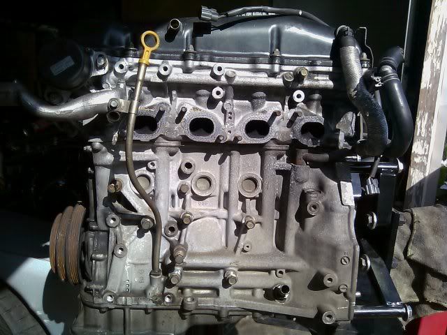

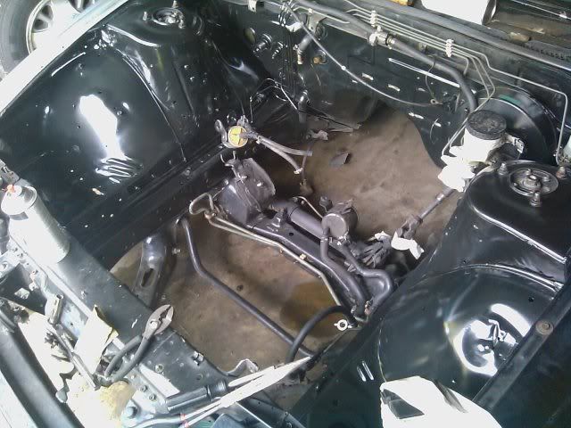

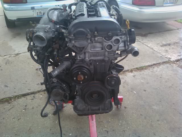

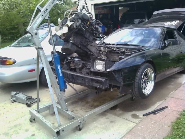

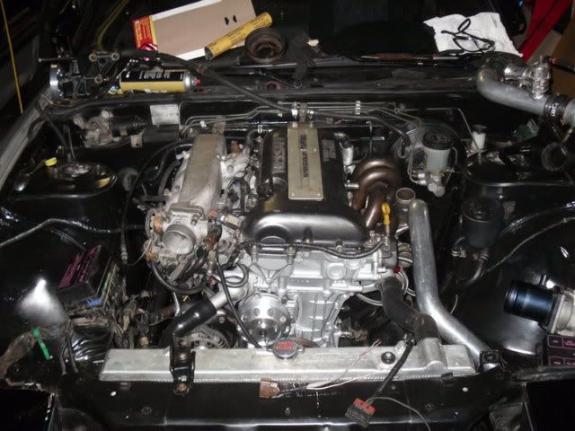

Back in April i was driving in the city when i hit a manhole (chicago streets slammed car, no bueno). I was goin about 35 mph so i thought forsure i busted my oil pan. got off to check and there was no signs of oil anywhere so i figured i got lucky.. WRONG I drove home about 45 min drive everything was still looking good. About an hour after i got home i went to turn my car on and the oil light was on valves were ticking crazy. I guess i broke the pick up and deprived the head from oil. Not wanting to look into it i jumped on an s14 sr a buddy had. with extra goodies and was already wired for a dohc s13.

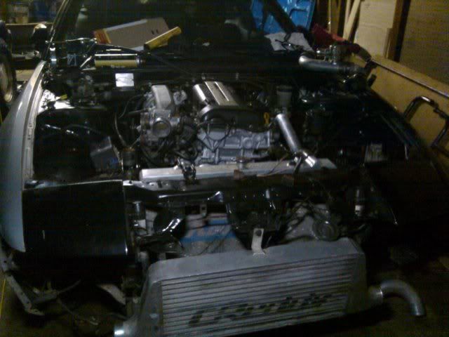

Pulled the ka, few things i got Greddy fmic,koyo rad, blitz bov, turbo lines, nismo mounts, isis screamer pipe 9lb flywheel isis pulleys

Ooo Dang broke build 0_IMAG0040

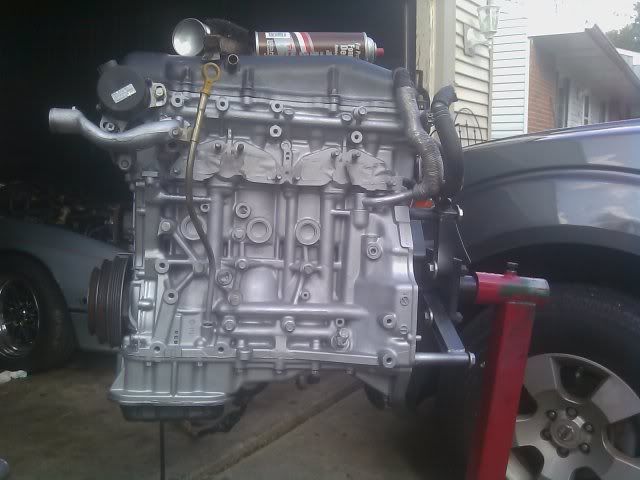

Made the block look a bit better
Ooo Dang broke build IMAG0053
Ooo Dang broke build IMAG0055

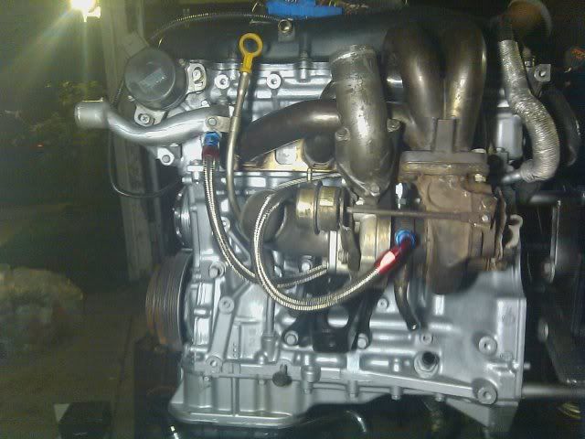

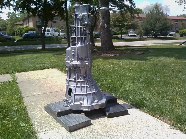

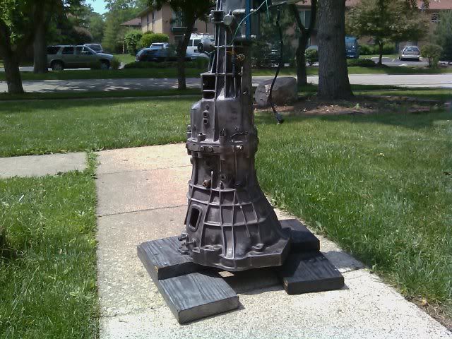

Degreased and painted the trans
Ooo Dang broke build IMAG0058
Ooo Dang broke build IMAG0059
Started putting everything back on with new gaskets
Ooo Dang broke build IMAG0097
Ooo Dang broke build IMAG0099
and BAM as it sits.
Ooo Dang broke build 29060_433589539873_642764873_555938
Ooo Dang broke build IMAG0113
Im tryign to figure out why i have no spark at the moment i think it might be a bad ignitor, just waiting for a buddy to come by with his to see if she will start once that happens all piping and other shit gets hooked up.
