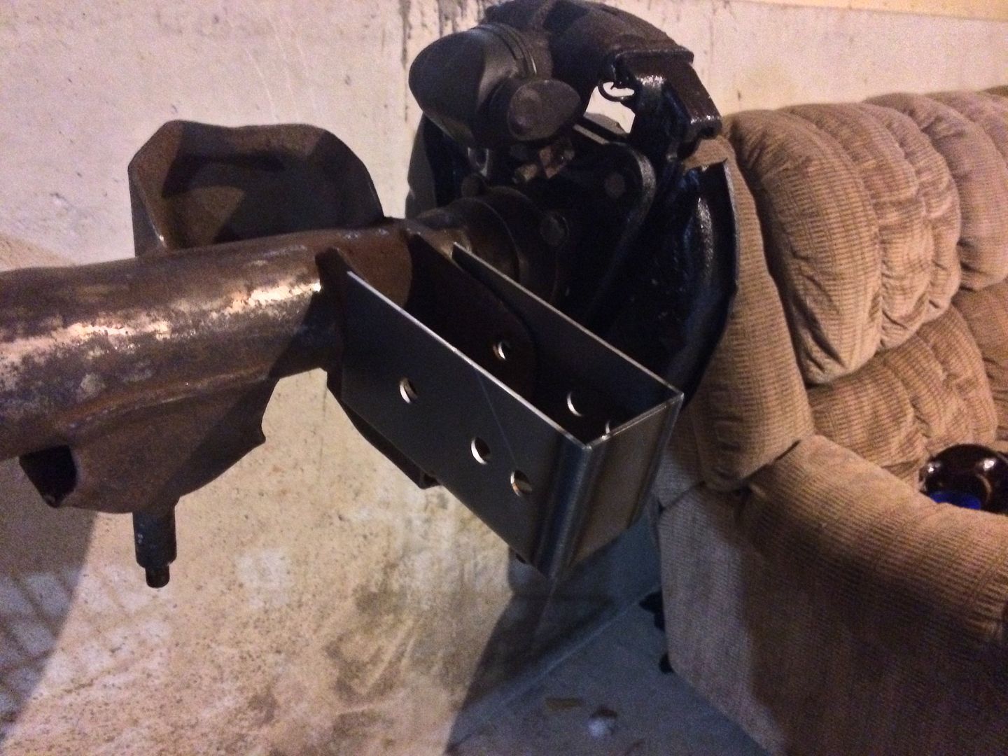

Test fitted the traction brackets. dead nuts fitment on the first try. Not bad having programmed the dimensions based on measurements I took with a shitty tape measure.
Living that 86 life... - Page 4 39573DEF-C53F-408D-B9BF-4D69E12A88EC_zpsmidpxfxp
Living that 86 life... - Page 4 830E51B5-31CB-48C3-A542-D9679EF4D1EF_zpsjnggiauu

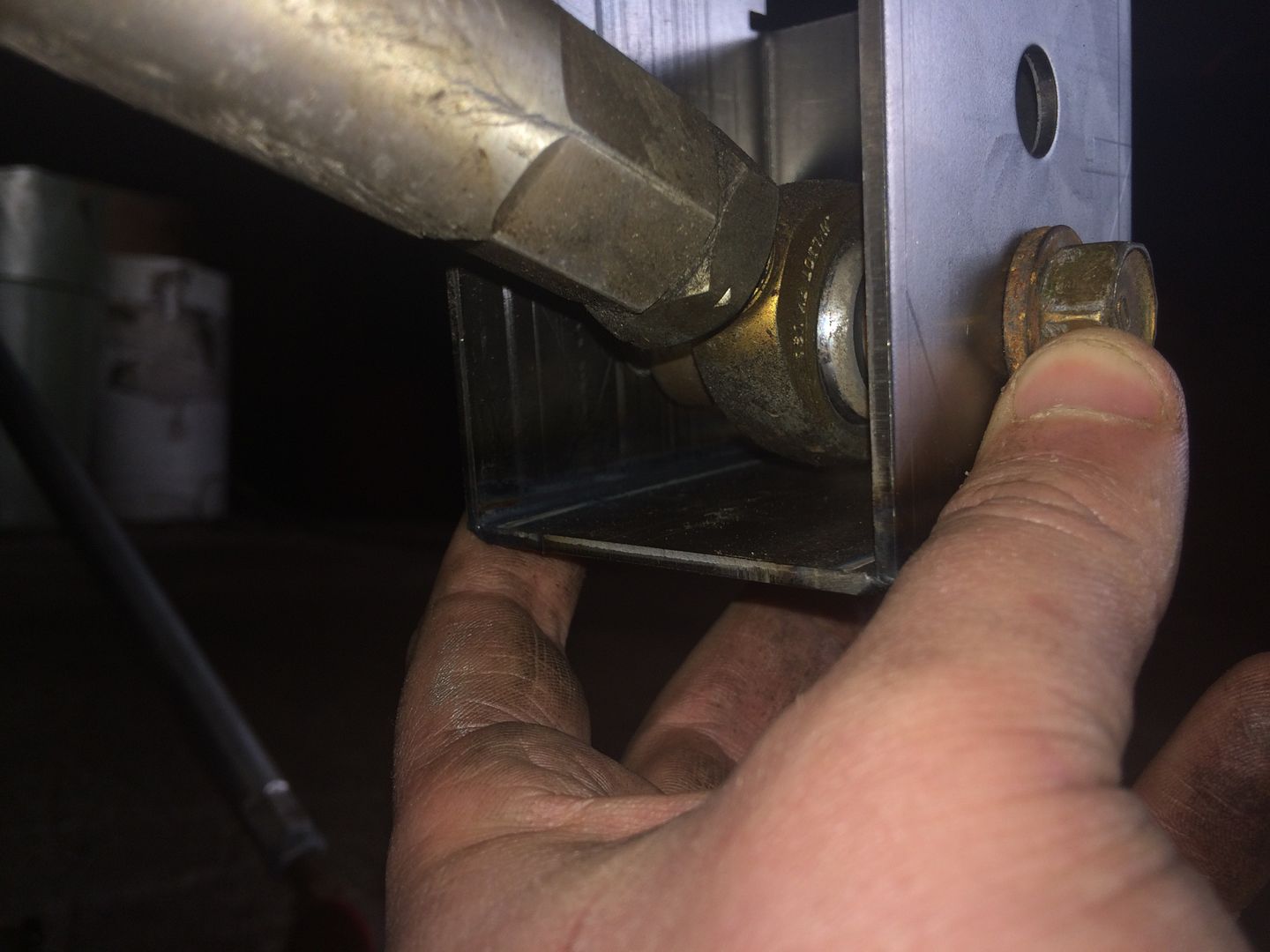

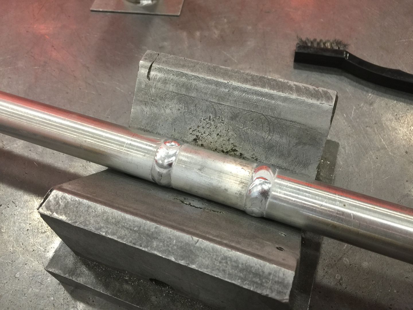

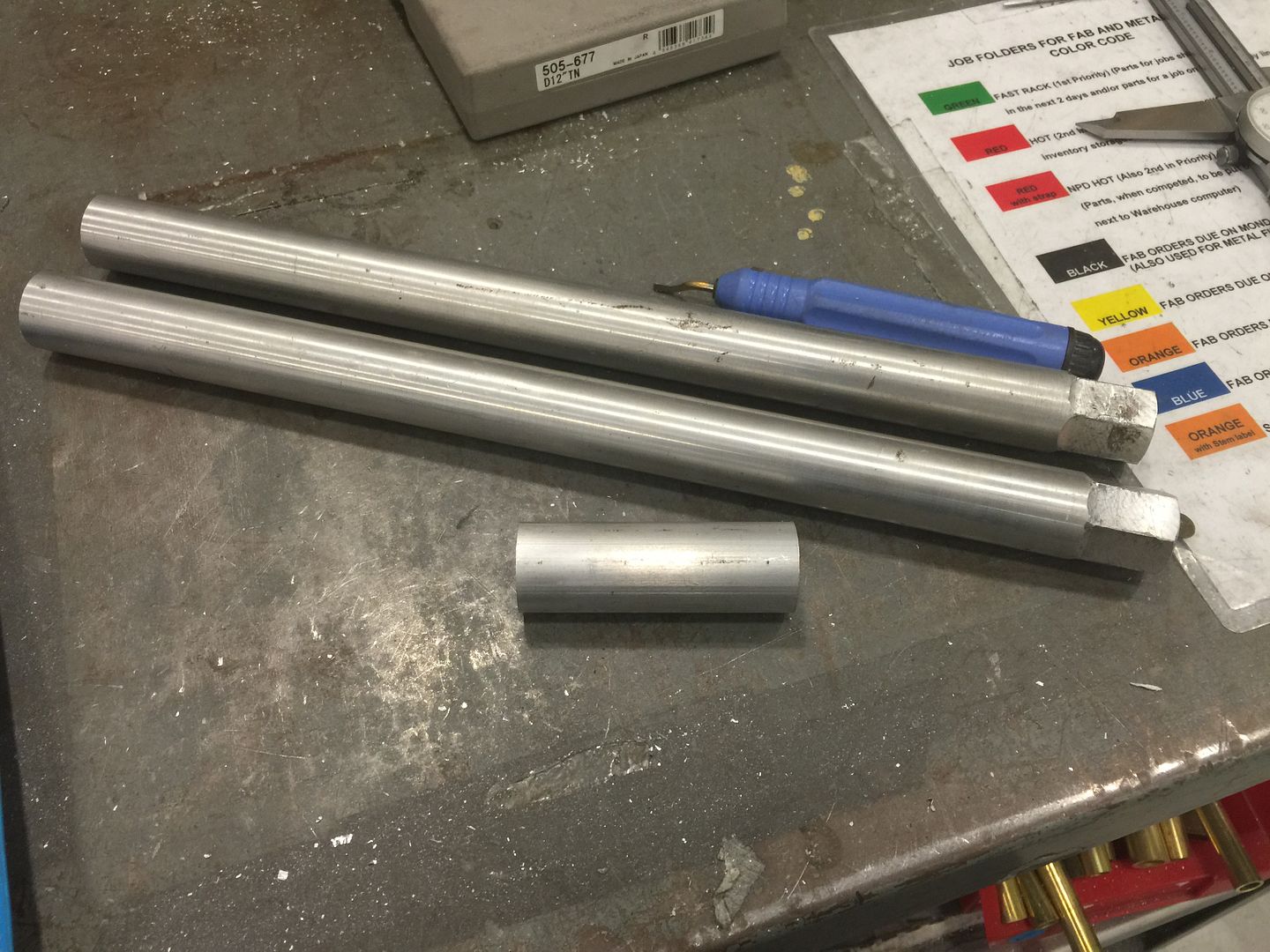

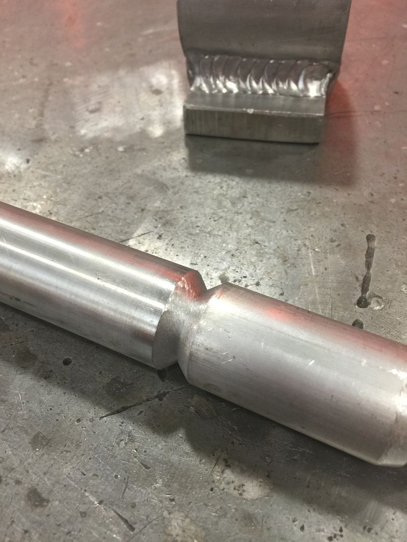

Satty took my panhard bar with him last time he was here so that he could extend it, that got done today.
chopped in half with extension piece before machining.
Living that 86 life... - Page 4 85BFC3BB-A275-47EB-BAB0-89CD5525C6CB_zpstuhahi1o
machined down for a perfect press fit into the old bar sections
Living that 86 life... - Page 4 4F605B05-F9F5-4A0F-8629-844F30B467A4_zpsr2kbvq5f
beveled the edges for welding
Living that 86 life... - Page 4 DB02382F-7E0D-44C4-802D-E3B7D1F076B3_zpssutsrnwh
and finally, welded up.
Living that 86 life... - Page 4 9ADD39F6-C6CB-484A-9408-86AD9811D5B5_zpsdppleewo

Those welds looks really good. I never got the hang of aluminum welding.

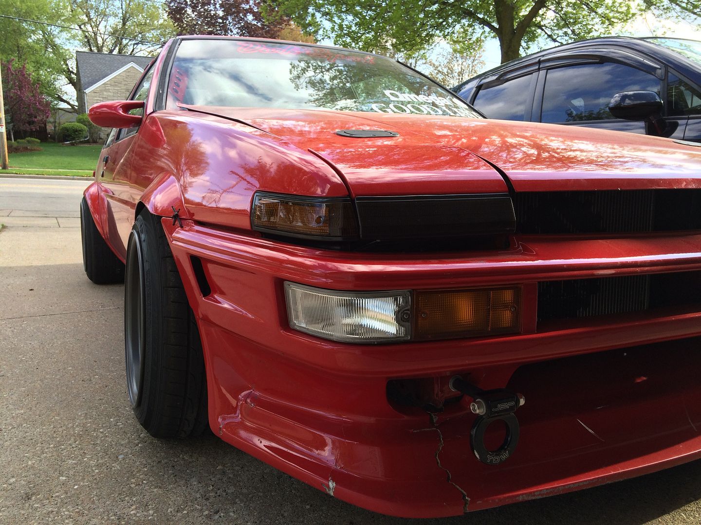

update on this, put mirrors and front bumper on. alignment this week, and maybe some window tint. Been dailying it and having a blast.

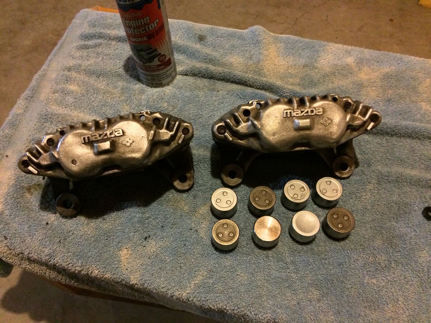

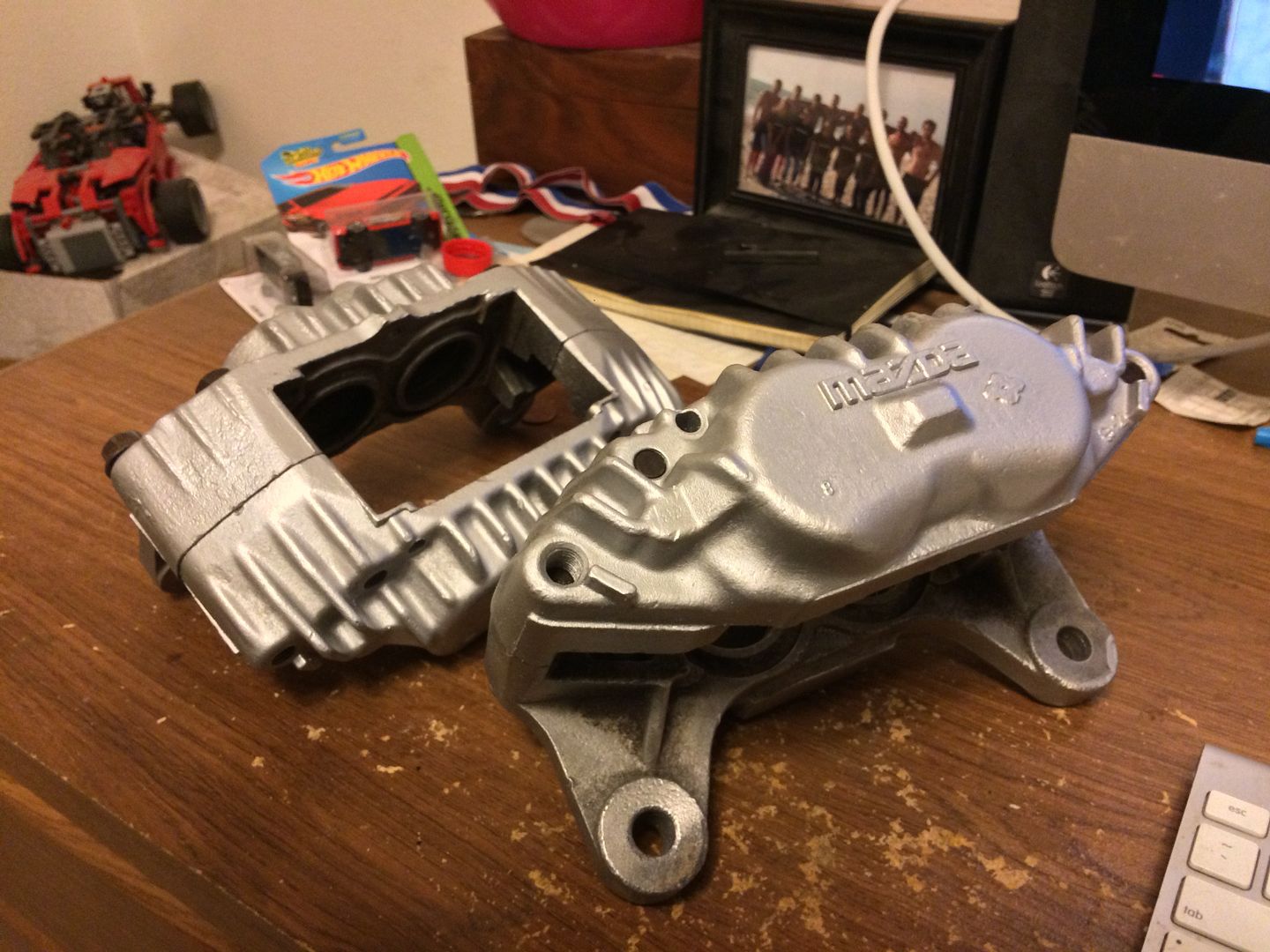

and decided to finally do a brake upgrade. Snagged these calipers from a local turbo FC nerd for dirt cheap, got them disassembled, cleaned and painted. Going to rebuild them and order the rest of the stuff for the conversion after DD52.

You did an awesome job on those calipers. They look so damn clean. Are you painting them?

calipers are painted in that second pic.
