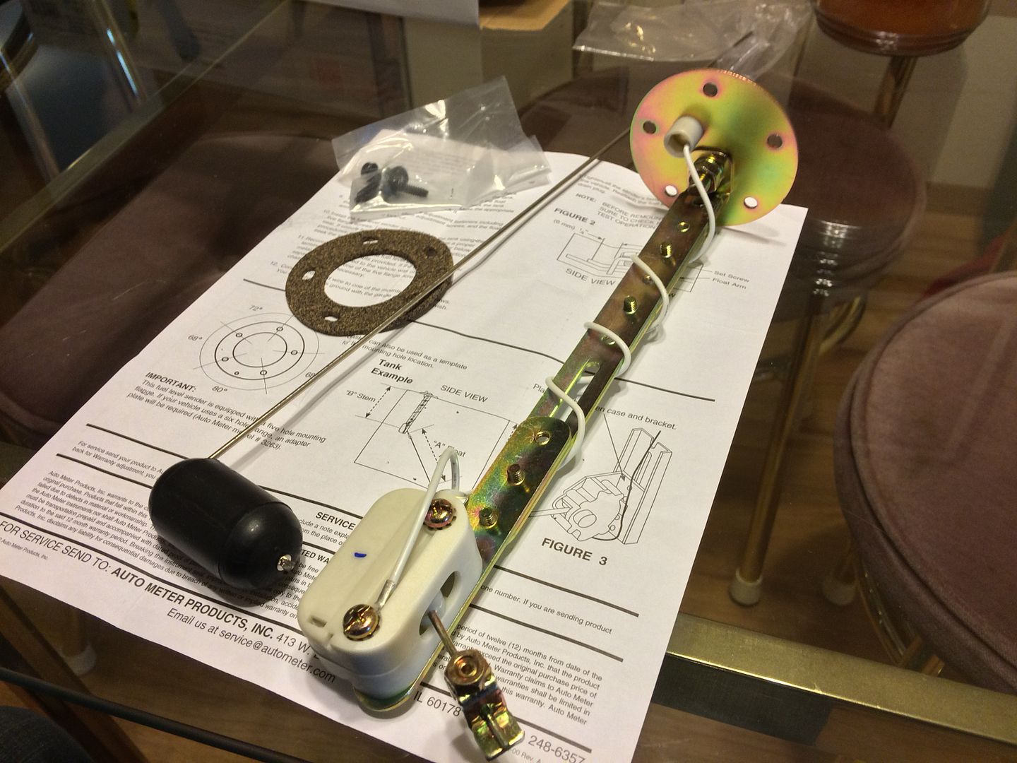

As most of you know, I don't have a working fuel gauge, hence why I ran out of gas on the highway and missed almost our whole BBQ/meet in the spring.
anyways, Kevin came to my rescue then, and he came to my rescue again and sent me this cool auto meter fuel sender thing.
Living that 86 life... - Page 2 ADCA672C-FD3D-4518-B171-21369DE1A298_zps9ust31os

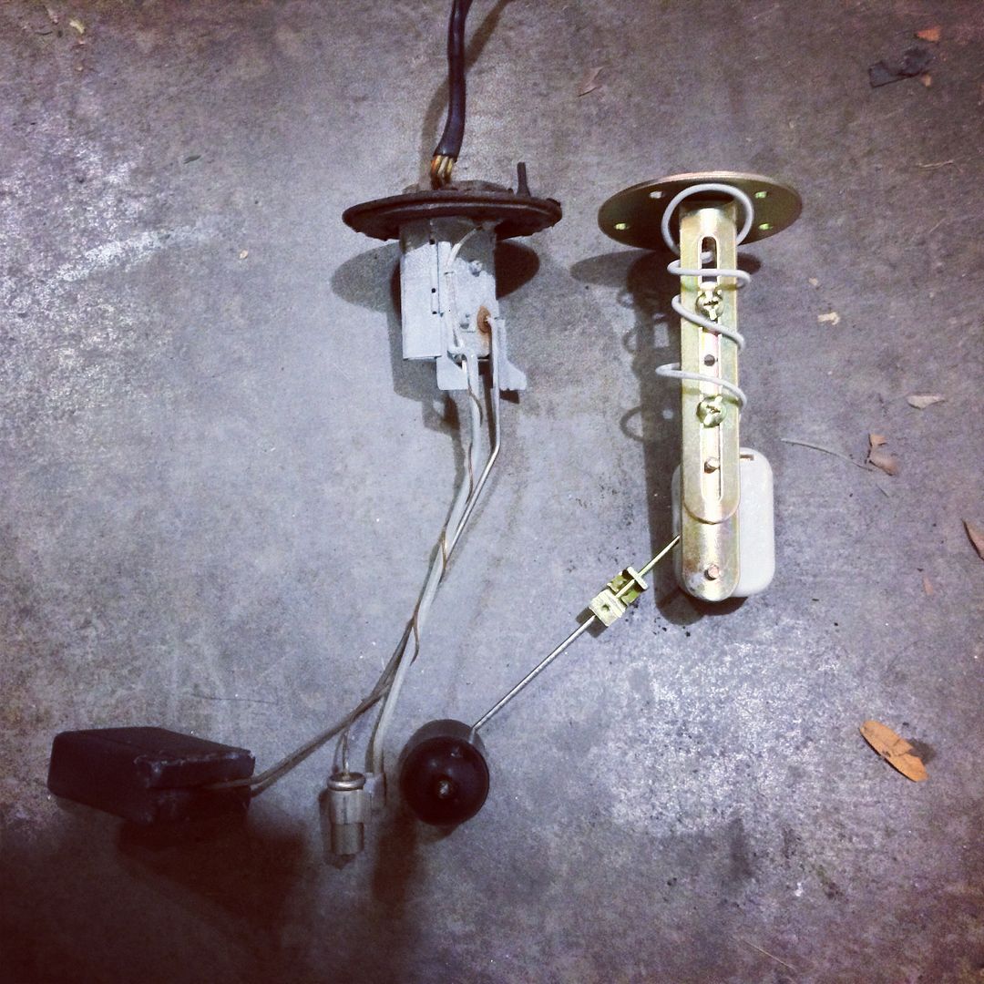

It basically involves taking a depth measurement in your tank and then adjusting the depth of the sender and cutting your float arm to a certain length.
Started doing that.
Living that 86 life... - Page 2 3F9A6C7A-15C2-48CA-B4A3-3164D6D1B677_zpsnl6worvc
New vs Old.
Living that 86 life... - Page 2 92BBAF96-2BFE-4839-A35A-C69490CA3E09_zps9gckzxe2

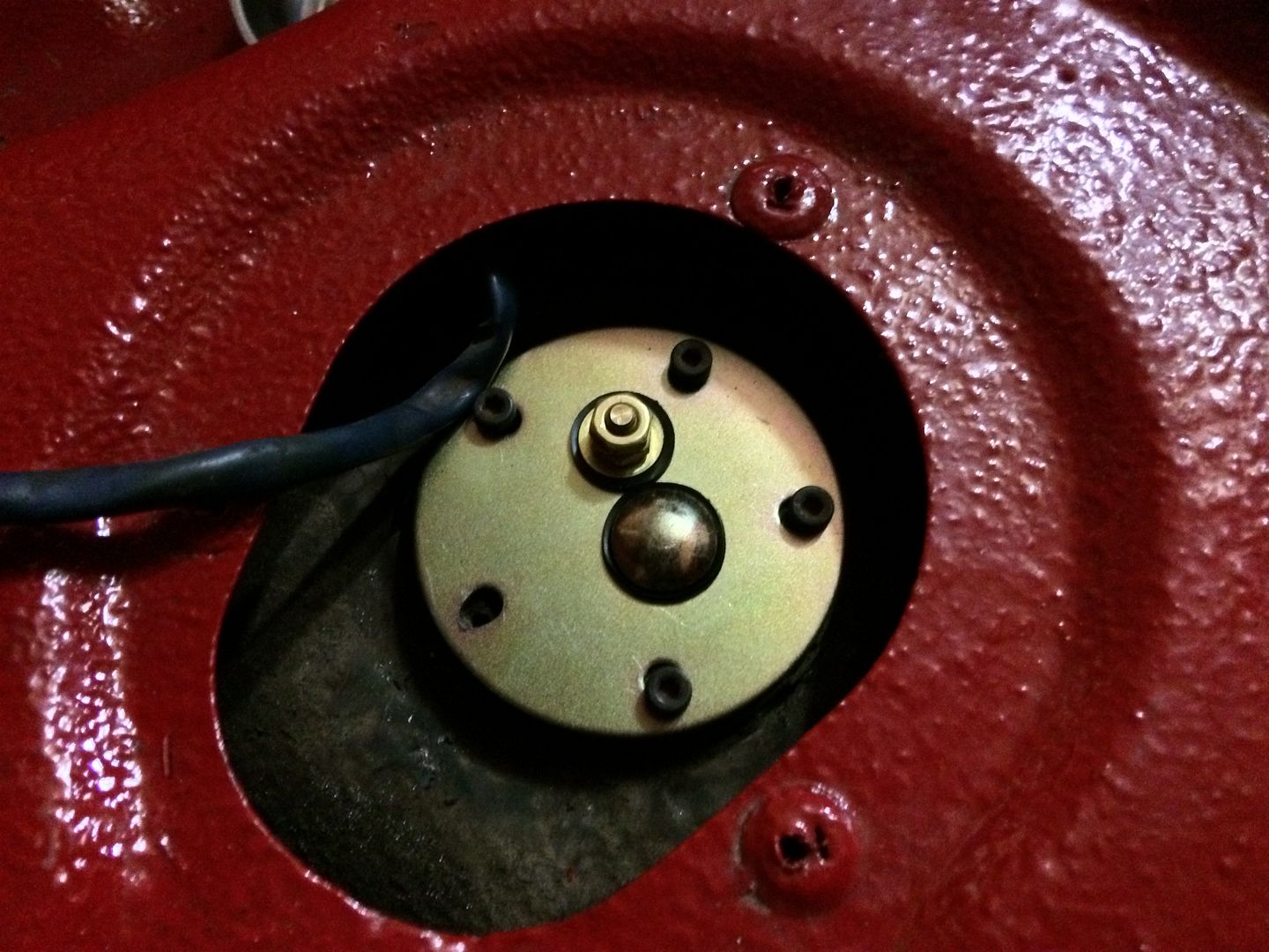

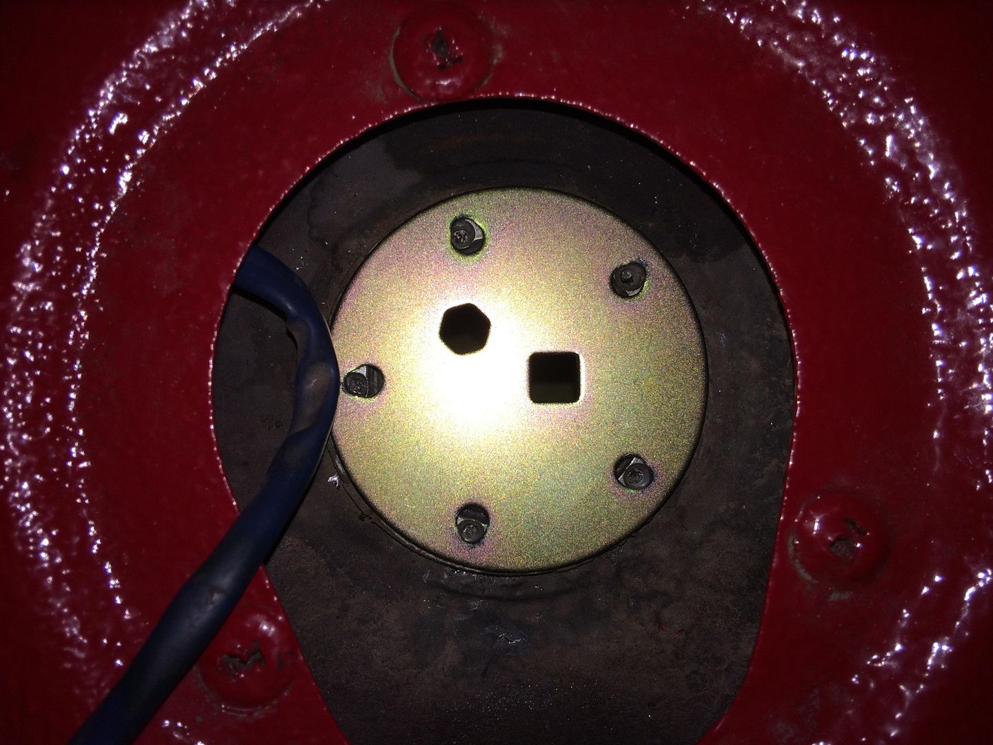

Surprisingly the non-symmetrical 5 bolt pattern on the auto meter unit matched the toyota pattern nearly perfect. The bolt spacing was dead on, but the toyota pattern had a tad bit larger bcd. I took the sender unit apart and used a small file to egg the holes out about 2-3mm on the mounting flange. Worked out well.
[img]Living that 86 life... - Page 2 A8319A35-5615-4616-9242-D1BE81B7385A_zpsbcgawqd5[/img]
Then put it back together and installed. One of my allen bolts stripped taking the stock one out and had to be drilled, so that's why I'm missing a bolt.
Living that 86 life... - Page 2 F507F38D-3297-4B56-931D-B332F0EF22FE_zpswod3eve7
My car is on jack stands, so I haven't had a chance to go to a gas station and calibrate the STACK, but I'm psyched to have a working gas gauge for once.

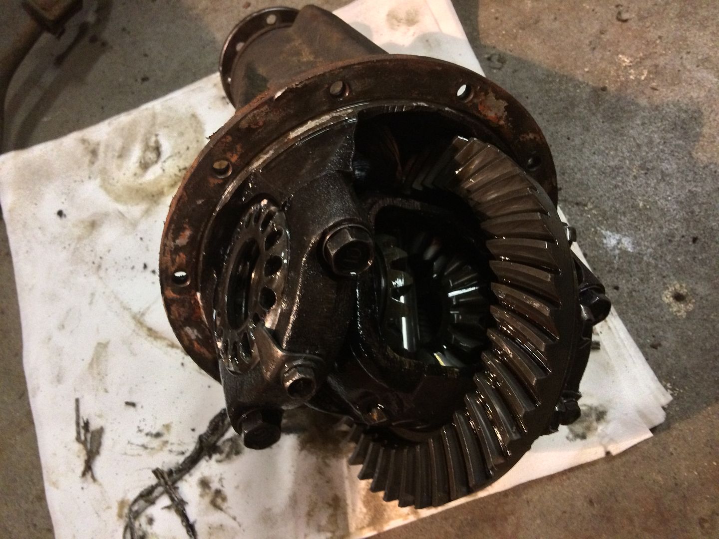

rear end is out and car is officially put away for winter. Sold the busted GTS rear and picking up an MA47 supra rear end on friday. Have a good winter, dudes.

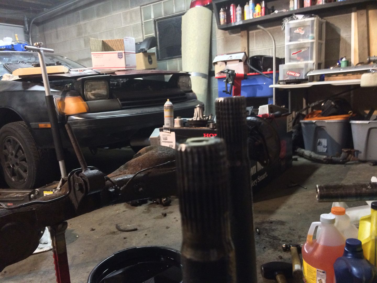

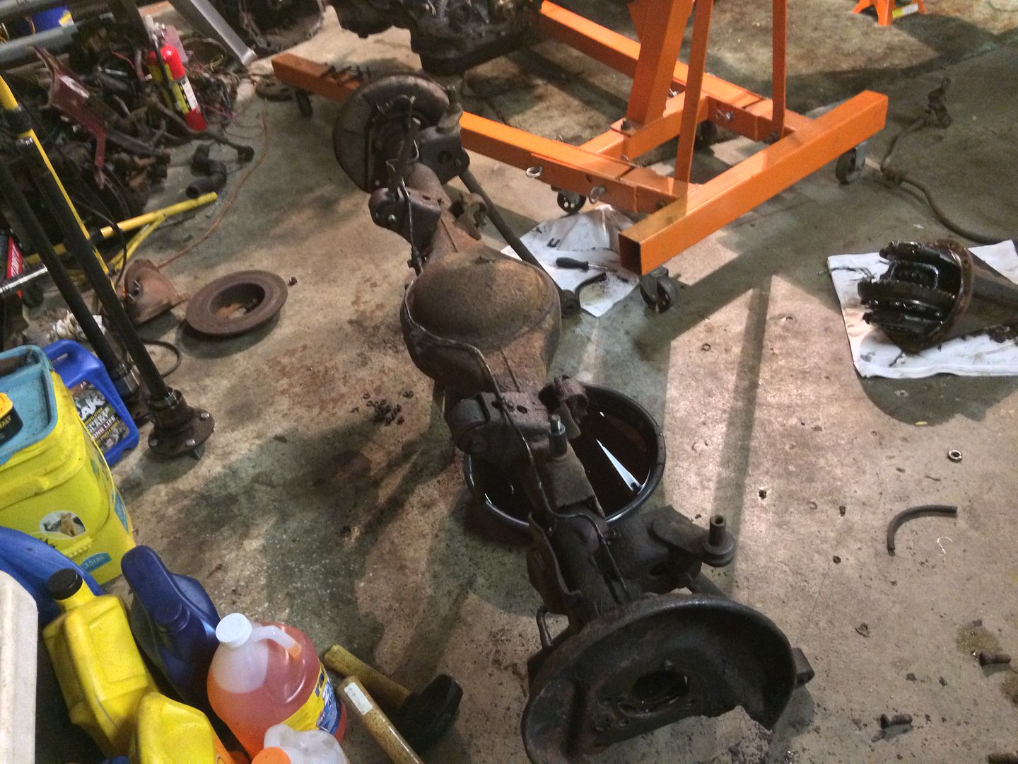

I found a buyer for my broken rear end and with the help of the chicago PR corolla dudes I was able to pick up the holy grail of rear end upgrades; a complete 1979 supra 7.5" rear axle. These things are virtually impossible to find, since mk1 supras basically don't exist. I also didnt pay a dime for it, and got a free hood out of the deal. I'm mega psyched about it.
It was pretty rusty when I grabbed it and it still had all of the 4 links on it. Of course all the bolts were seized.
Living that 86 life... - Page 2 8F9B3530-3057-4894-A1EF-8F66D4ED5B94_zpsajw12c7u
got it back to sattys and started pulling it apart to assess the condition.
Living that 86 life... - Page 2 E8454E86-2EBB-42C6-91DD-F33348D78069_zps50bt62oj
These axles are beefy as fuck. supposed to be good for like 400hp!
Living that 86 life... - Page 2 74DD2F53-41F4-4E95-B36C-903CD814AAB2_zpshxldhiqz
To our surprise, we found that the entire rear end was freshly rebuilt, all new axle, carrier and pinion bearings, and best of all? It has fresh and new 4.3 gears, which is going to save me a bunch of money.
Living that 86 life... - Page 2 7777E7EF-7A88-42A4-A069-8D64122C89E3_zpsydsiflyl
the calipers, though rusty look to be fairly new or freshly rebuilt. I was able to get the brake lines and bleeder screws out without too much of a fuss. Calipers without slide pins are strange.
Living that 86 life... - Page 2 9F04F676-0F21-42EE-85FD-20CD39169024_zpsxafyygpd
Got lucky and my dual drilled pinion snout from my old diff swapped right on, so no re-drilling will be necessary for my DSS driveshaft.
Living that 86 life... - Page 2 B99E6514-C016-47B2-835E-5C5558251321_zpshnveapmo
installed extended studs right away since it was missing a couple.
Living that 86 life... - Page 2 AB425330-B8F4-40B1-BC9B-77ED4C713979_zpszuudlqcs
then put everything back together, removed the backing plates and brake hard lines and started going to town with a flapper wheel on my angle grinder to get all the rust off. Its starting to look pretty good. We have to do a few modifications to the housing, and then i'll paint it something fancy.

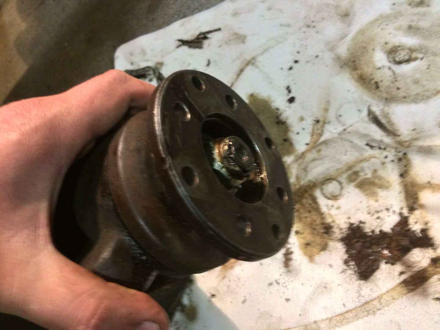

Got my knuckles today from Paz in the UK. These should be fun. Going to take the spare LCA you seen in the pics and extend/box them in and pick up some different tension rods too, probably Tein. Should pair well and give me good angle without any clearance issues, reduced ackerman and much better turn in response.
Living that 86 life... - Page 2 53ACB7B1-76B2-432C-B960-C8D3C9FF37FC_zpsz6hpfo8a
Living that 86 life... - Page 2 CA03AC7E-AB6C-458A-992C-42E862FCBEAE_zpsidqas4mx
