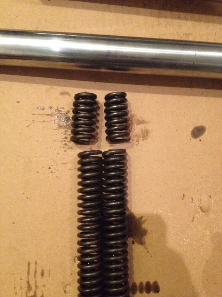

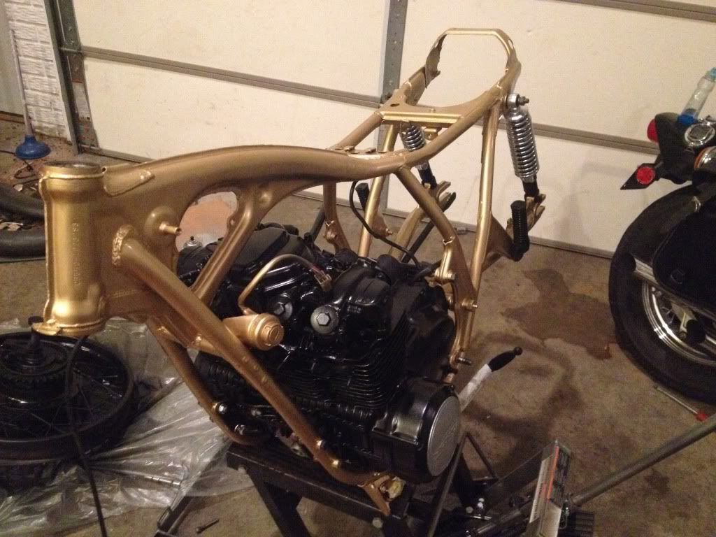

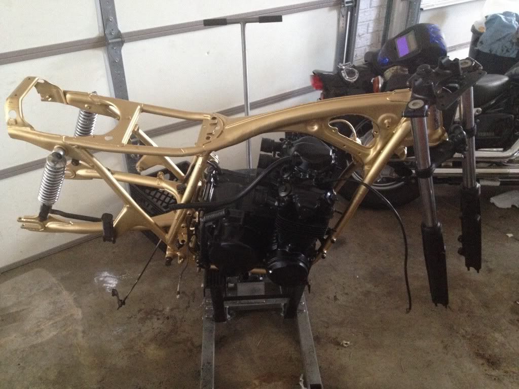

Worked on it a little yesterday. Got the motor back in and mounted the front and rear suspension. The rear has a set of 1.6'' drop shorty shocks and the front I decided to cut 2" inches off the fork springs. This should result in the low aggressive stance I'm aiming for. Also got the front end painted.

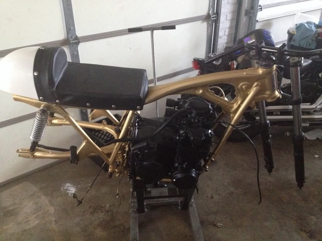

Just another teaser pic with the unpainted seat.
