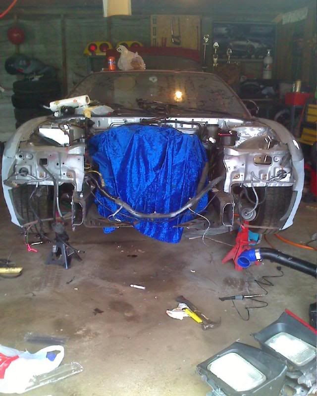

so engine is in... and core support is out? seems like a bad idea.
one step forward, three steps back
FUCK, i'm starting to hate cars.
PostSubject: Re: Flat brim DC hats and White plastic framed sunglasses.   April 26th 2009, 4:49 pm
Core support fab is intimidating.
What have you done?!
V-mount setup comes with the dudes already fabbed core support?
PostSubject: Re: Flat brim DC hats and White plastic framed sunglasses.   April 26th 2009, 4:59 pm
it came with the two side pieces on the upper part, with intercooler tabs welded on. but we decided that instead of going through the hassle of drilling mine out, riveting new ones, and repainting, we just cut mine along the same lines his were cut, and were gong to weld in some tabs for the intercooler.
the only real fabrication we need to do is a lower bar to replace the original lower radiator support, (the part that the tension rod brackets bolt to. and then the outter hoop that acts as a lower radiator mount.
it will all be done next weekend when satty brings his welder up here.
along with assembling the lines for the oil cooler.
the engine is just covered up in the pictures because i'm waiting on my new valve cover
everything else is pretty much good to go, just need little things like gauges and an SS clutch line to get it driving again.

PostSubject: Re: Flat brim DC hats and White plastic framed sunglasses.   April 27th 2009, 3:35 pm
I spot n2o bottle and a pair of R33 tails.
Looks like some wire tucking is in order too Wink
PostSubject: Re: Flat brim DC hats and White plastic framed sunglasses.   April 27th 2009, 3:40 pm
the bottle is from an intercooler sprayer kit, its just decoration now. the tails area also decoration. we use them to test paint colors.
and yea. wire tucking. i HATE wiring. anything beyond plugging in a connector is way over my head. and speaking of wiring. we accidentally chopped almost my whole engine harness in half cutting the radiator support off, definitely didnt realize it was under there...
an hour and $19 at radioshack and its good as new.
