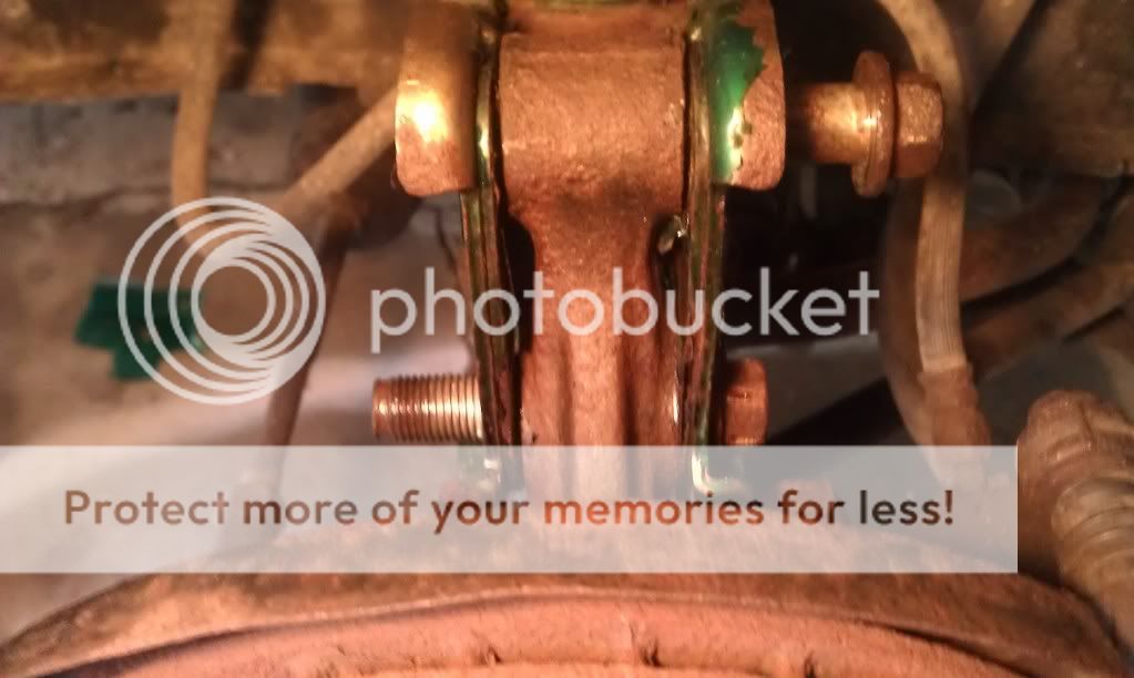

alright... trying to finish up a trade i have going right now.. rear coils are off, stock are back on for this winter beater s14 i got that will end up being a daily while i save up money at the new job to buy a car to build this spring...
removing the front coilovers.. and this bottom bolt in the shock mount is fucking siezed.
i've already gone thru a can of PB blaster, and used up half of my propane torch...
any other ideas to get this piece of shit off? i tried removing the calipers and shit, and a nut snapped on there.
so fucking pissed right now i think i'm about to flip the car off jack stands into the side of my garage.
fuck this thing..
HALP!
Fusion's Build/Mods/pics! - Page 25 IMAG0418
that bottom one wont move..

HAMMERTIME!

Use a air hammer or muscle.

Hammer that shit like you aren't a pussy

If that doesnt work, or if you wanna hammer like a pussy, You can also try taking the top bolt completely out, then hammering on the spindle itself/yank the damper assembly towards you to get it to 'change camber' sort of. That might free it somewhat. Then continue hammering the bolt?

Seriously, you're probably using the wrong hammer. Get a mini sledge and it'll come out like it's scared of you.

Im a skinny fuck, but Ive had bottom bolts get stuck in there pretty bad, especially like if you take the top bolt out first and it pivots out and kind of shears the bolt in the bottom hole, even then you can just hammer the shit out of it like whoah and it slides right out.

dude. i'm using a BIGASSMOTHERFUCKINHAMMER. shit wont budge. torched it and everything. i'm gona beat the fuck out of it 2mor when i wake up hungover. i bet my bad breathe will scare it away.

try using a vise with a block and press it out like shown below.
you can also try using a piece of pipe that will fit over the bolt and do the same thing with a vice

damn. that's badass. thanks for the illustration, i got it off but that's cool.
but now... my brake line CRACKED. right be the bend where it dips by the rear wheel ish. i'll take a pic/vid soon. it's like a fuckin super soaker haha.
but, where can i get a hard brake line for that?
