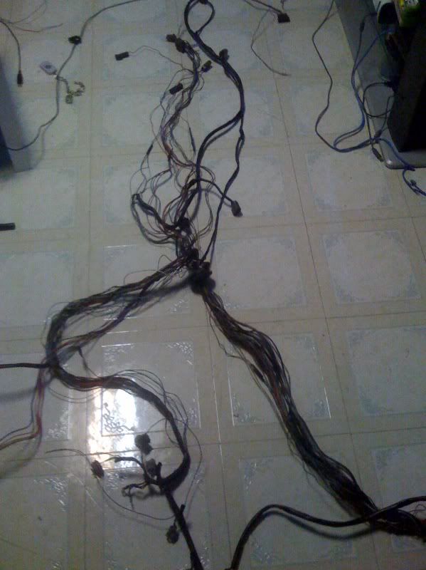

redoing my harness before my new motor gets here shits a mess right now removed all the useless plugs and wires but it will be clean as fuck when im done to bad it will be so tucked nobody will see it

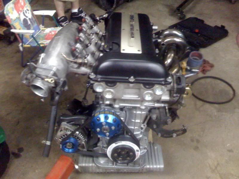

got my shit.this will be the last sr i put in this car if i blow this one up im going rb25 and im not a dreamer im real talk
ON TO THE NEXT ONE! - Page 4 Photo11
Head
-MBV Solid Lash Adjusters and Cam-cap Stud Kit
-Peak RAS
-Brian Crower 264 cams (oem gears)
-Brian Crower spring/ retainer kit
-JWT bronze valve guides both sides
-OEM valve stem seals both sides
-3 angle valve job
-apex-i head gasket
-arp head studs
Block
-Knife edged crank
-cp 8.5cr .020 over pistons
-eagle rods
-arp main studs
-all new oem Nissan bearings
Engine externals
-2871r .64 turbo
-deatschworks 550cc injectors
-z32 maf
-sard fpr
-freddy intake
-walbro 255lph
-Greddy pullys
-ATI damper
-GReddy oil pan
-A-pex’i Power FC with commander
we'll see what happens at the dyno

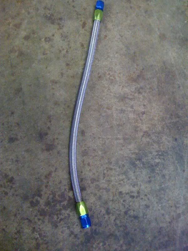

plus i made some custom turbo lines
ON TO THE NEXT ONE! - Page 4 Photo12

i like the green and blue fittings

yea i was going to do black and green but i like the blue better.if you guys want some custom turbo lines hit me up i could get like 8 colors

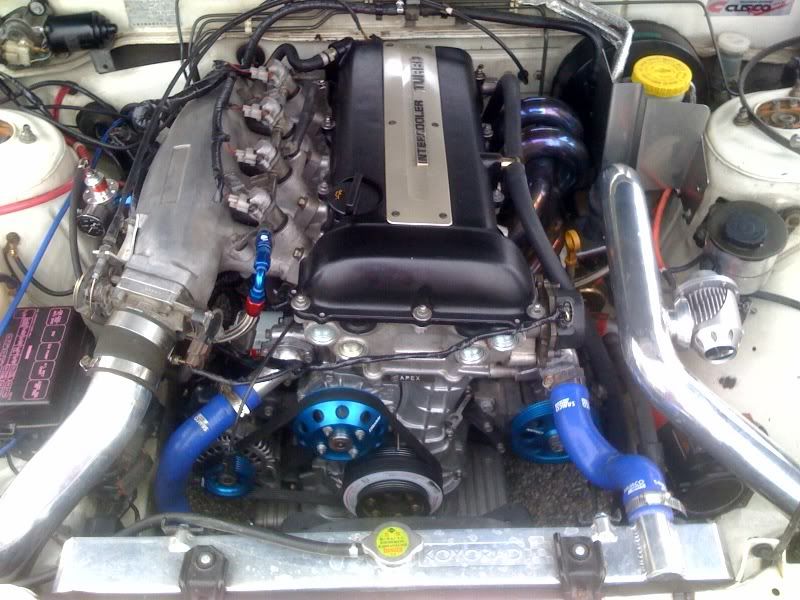

motor is in and beasting lmao(when i get my new rail and injectors the harness will be fully tucked under the manifold)
