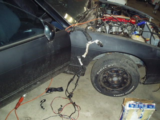

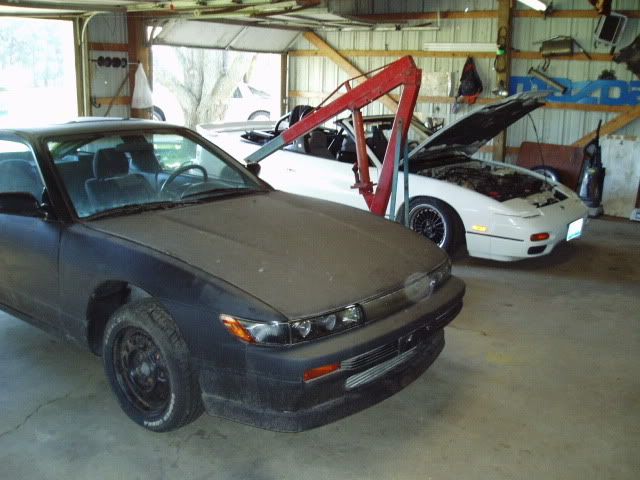

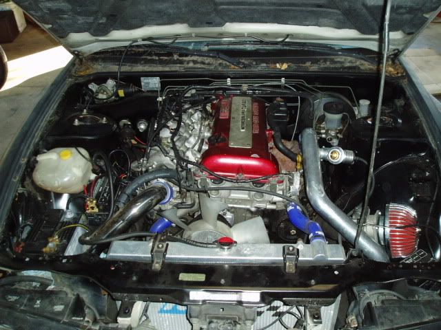

Well, I'm a pussy and couldn't just leave you guys high and dry. Maybe I'm just a nice guy. IDK. Anyway, I picked myself up a 89 hatchback with a fairly stock SR20DET in it. The guy had swapped it, but could not figure out how to start it. He could jump the starter and it would run fine and everything, but couldn't turn key. Anyway, I figured 3k for a nearly rust free car, SR20DET, Mine's Tuned ECU (Has verification plate applied to it Smile), N1 Style exhaust, test pipe, downpipe, FMIC, TurboXS RFL, Koyo radiator, Short shifter, and tein tension rods I couldn't pass it up. Anyway, so after about 3 hours of real work and about 3 hours of scratching the dome over the wiring I got from this:
IDK if this is really just cosmetic... SR-KAswapsDay110-20-07003
To This... H3M4N STYL3 Y0!~!
IDK if this is really just cosmetic... SR-KAswapsDay110-20-07055
The wiring problem wasn't really the problem at all. All the wiring checked out perfect and everything was getting connection. Turns out that among all my retartedness when I was checking resistance I wasn't pushing in the clutch pedal when imitating starting the car. After realizing this, continued with the pedal down and was getting the same results. My wiring expert went under to see if the neutral saftey switch was hooked up and it was, but it was not making contact with the pedal in the full down. A little tweak later and everything checks out flawlessly. WOOHOO!!!!
So yeah, I'm putting the SR into the vert and putting the KA into the Hatch. Hatch is going to be my winter car for this year at least and the vert is going in storage in the next 2-3 weeks. When next spring comes around, IDK what I'm going to do yet. Maybe the SR will convince me to keep both and possibly do a few things to the hatch for my G/F? IDK... just some thoughts rollin around the ol' noggin.

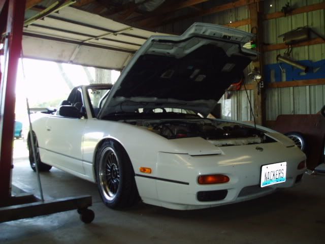

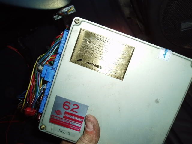

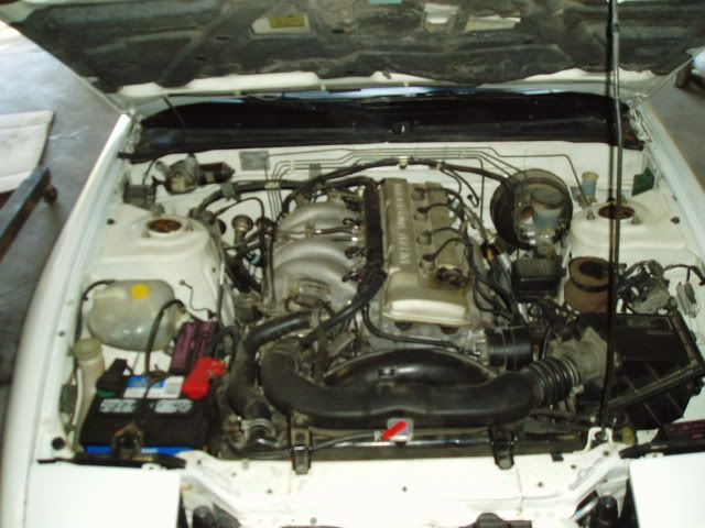

Here are some more pics.
IDK if this is really just cosmetic... SR-KAswapsDay110-20-07001
IDK if this is really just cosmetic... SR-KAswapsDay110-20-07002
IDK if this is really just cosmetic... SR-KAswapsDay110-20-07004
IDK if this is really just cosmetic... SR-KAswapsDay110-20-07047
IDK if this is really just cosmetic... SR-KAswapsDay110-20-07050

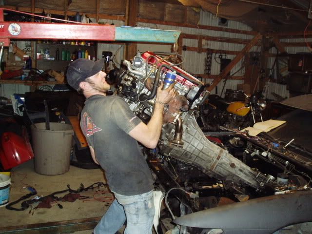

Another update. KA is out of the vert and sitting on the ground. Took the top nut off the motor mounts and did it that way. After getting the motor out we noticed that the left mount is done for so I have to get them out anyway. IDK exactly what I'm gonna do, but I'll get to it. Also, IDK why this is a growing trend around here but my left wheel's stud stripped out as well. Not really too worried about it since I need tires for the bitch I'm gonna take it to the shop and be like "Oh, thats horrible!!! What ever shall I do?" and see if they won't fix it.
I got my camera tonite so here are some pics.
IDK if this is really just cosmetic... SR-KAswapsDay310-22-07002
IDK if this is really just cosmetic... SR-KAswapsDay310-22-07003
IDK if this is really just cosmetic... SR-KAswapsDay310-22-07005
IDK if this is really just cosmetic... SR-KAswapsDay310-22-07014
IDK if this is really just cosmetic... SR-KAswapsDay310-22-07017
IDK if this is really just cosmetic... SR-KAswapsDay310-22-07020
And after taking out the KA, this shit is still low Smile.
